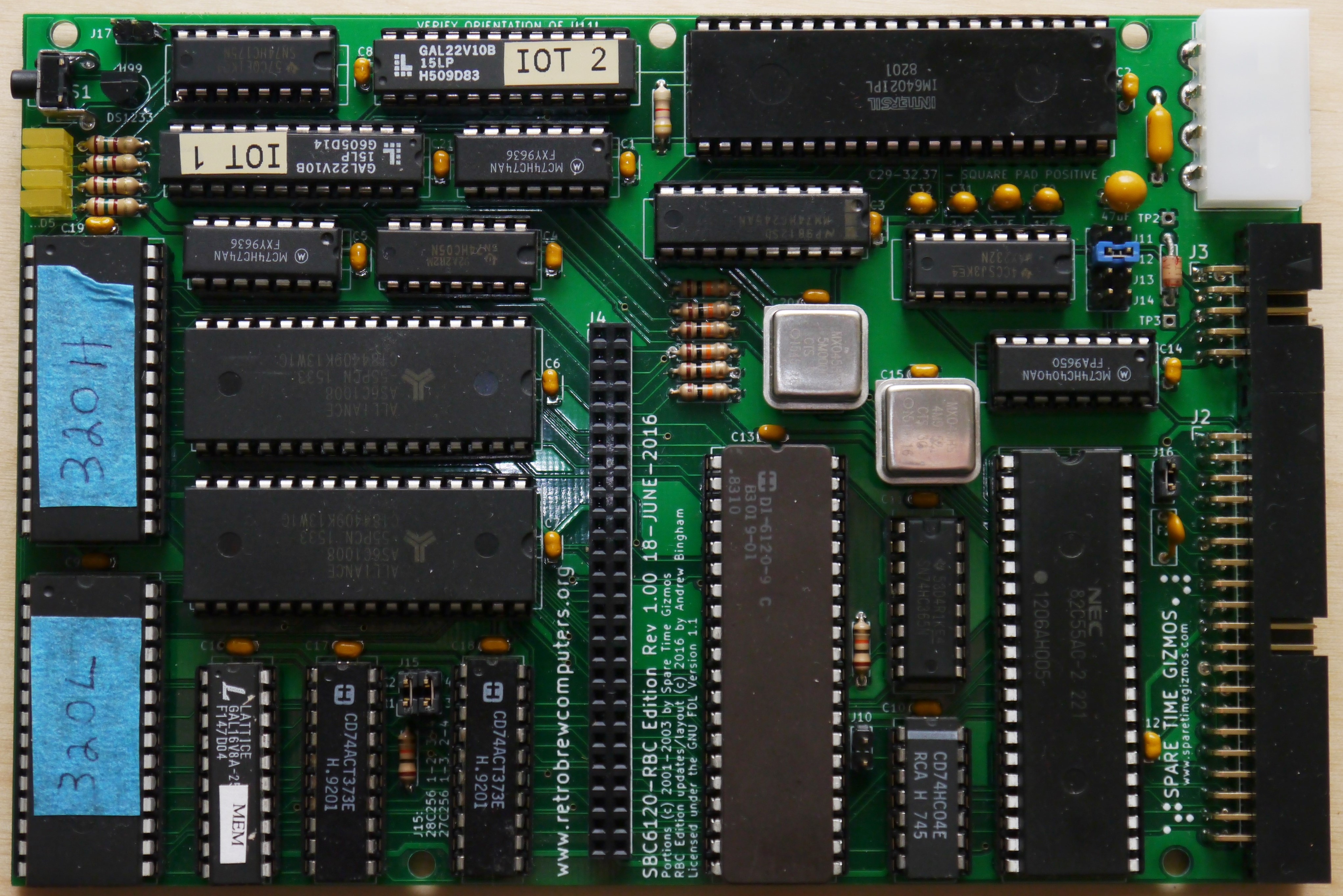

The SBC6120-RBC Edition is a re-implementation of the SBC6120 design into KiCAD as a 2-layer PCB layout. The original 4-layer PCB is relatively expensive to fabricate, which makes it difficult to distribute as a “hobbyist PCB” in the way the other RBC ECB, S-100, etc boards are distributed. Having the schematic and PCB layout in KiCAD will also benefit other community members who might want to make use of portions of the design which Bob has graciously made available.

SBC6120-RBC Edition Rev 1.10 Differences from Spare Time Gizmos SBC6120
Several changes have been made from the original SBC6120. Thanks to the 0.99 board builders for suggesting some of these:
- The board was re-routed as a 2-layer PCB using KiCAD & Freerouting.net open-source router. VCC and GND flood fill planes are included on the top and bottom of the board, respectively.
- The SRAM chips were changed from Qty 3 64k x 4-bit HM6208 to Qty 2 128k x 8-bit AS6C1008, which should be more available to builders.
- The post LED display was changed to allow the use of 4 individual square LEDs + resistors. The integrated LEDs display specified in the original STG BOM can still be used by installing jumper wires in place of the individual resistors. The LEDs moved slightly in position along the edge of the board.
- The reset switch was changed to a less expensive/more commonly available part/footprint. It also moved slightly in position along the edge of the board.
- A new jumper J15 was added which allows either 27C256 EPROMs or 28C256 EEPROMs to be used.
- A new jumper J16, fuse F2, and capacitor C22 were added which allow +5V power to be provided to Pin 20 of the IDE connector. These components are optional and allow some CompactFlash → IDE adapters to be powered directly by the board.
- TP1 was changed to J17, which includes the original /RESET test point and a GND pin to allow for an external, case-mounted reset switch to be connected if desired.
- A minor schematic error on the expansion connector of the original STG boards was corrected. J4, pin 10 was connected to pin 2 of the HD-6120 - signal DMAGNT - instead of the correct CPU pin 31 with signal INTGNT. This signal is not used by either of the existing expansion boards (FP6120 & IOB6120) so compatibility with these boards will be maintained.

RetroBrew style POST display installed in a Rev 1.00 board:
Spare Time Gizmos style post display installed in a Spare Time Gizmos board:
