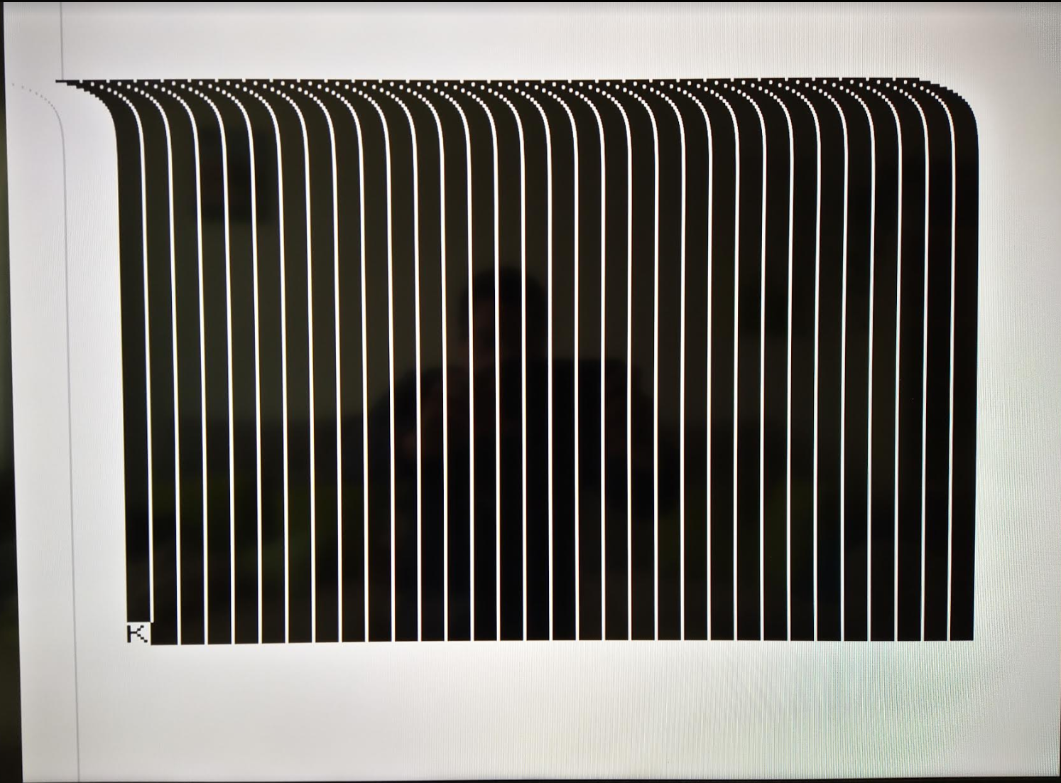

Re: ZX81+38 Build [message #7990 is a reply to message #7908] Thu, 01 October 2020 23:25 Go to previous message
ale500 is currently offline  ale500
Messages: 44
Registered: April 2018
I finally found the problem, it seems that the circuit around the Flip-flop to generate the nWAIT signal does not work, it never gets 'Preset' because the NMIs are disabled. One get a picture if the nWAIT signal is pulled high but with some distortion on the upper part of the screen. A two transistor fix, like in the original ZX81 is needed. A One transistor circuit should also work, I think. The ZX97 has two gates to generate this nWAIT signal, I'll try that because at the moment I have no PNP transistors....
